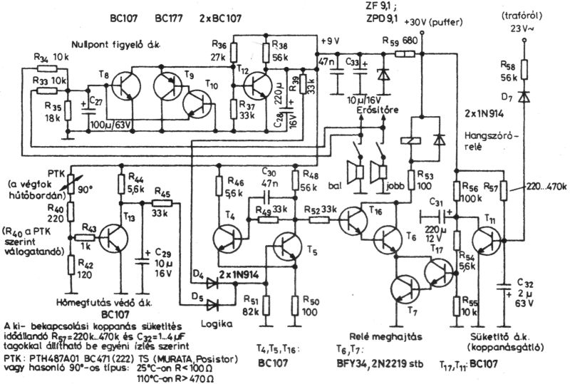

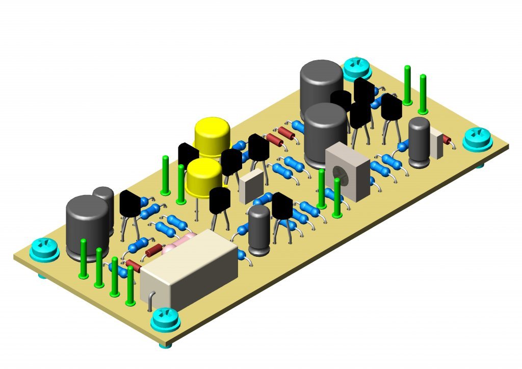

Hi, everybody! I want to ask. According to what scheme you did protection of speaker systems. Thank you!
(#) soos csaba válasza radio amateur hozzászólására (») Jún 15, 2012 /
HI, The picture that this is the connection of a theorem.
(#) radio amateur válasza soos csaba hozzászólására (») Jún 15, 2012 /
„HI, The picture that this is the connection of a theorem.”
Csaba, thanks for the scheme! You have a drawing of the printed-circuit board for it? It is possible in a format sprint layout, PDF, jpeg?
Hi, I managed to guess the documentation, I found no Lay-in, but so do you think is useful.
(#) radio amateur válasza soos csaba hozzászólására (») Jún 16, 2012 /
„Hi, I managed to guess the documentation, I found no Lay-in, but so do you think is useful.”
Köszönöm szépen!
Please tell what sizes the printed-circuit board should have.
Which relay did you use (its name, marking)?
The variable resistor should have resistance the 250th ohm?
Unfortunately I don't speak in Hungarian and my English not so good. I from the Russian Federation.

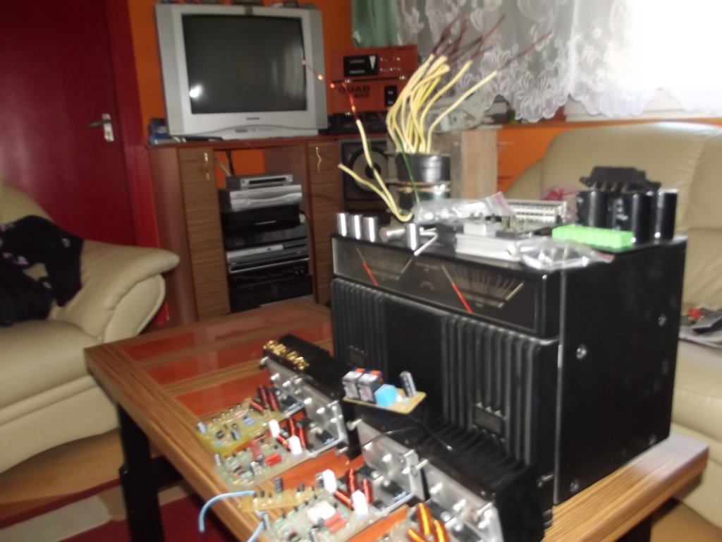

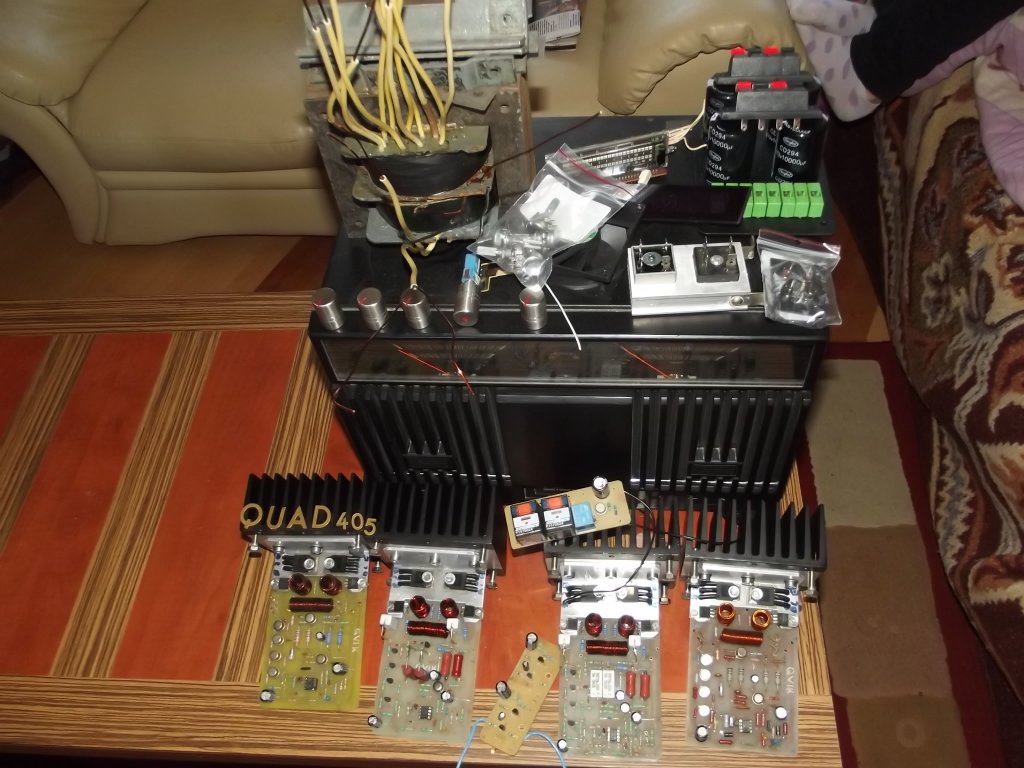

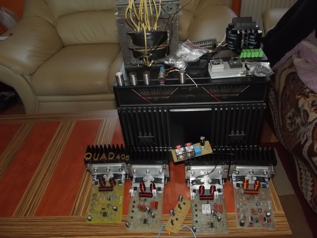

(#) qvik hozzászólása Jún 16, 2012 /
Készülőben a 19. Quad-om!! Mind a négy panelem elsőre indult!
(#) granpa válasza qvik hozzászólására (») Jún 16, 2012 /
[OFF]Bekerülsz a Guiness-be! A "százlábú" jó az első képen!
