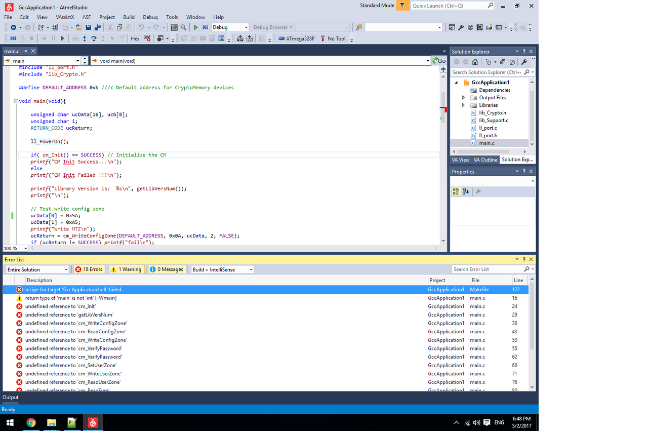

(#) david10 hozzászólása Máj 2, 2017 /
Innen letöltöttem az Atmel CryproMemory AVR könyvtárát.
A mintaprogramot megnyitottam au AVR Studio 7-ben, kiválasztottam az Atmega328-at, amikor rákattintok a Start Debugging-ra, akkor undefined reference hibákat adja elő:
  1. Severity        Code    Description     Project File    Line
  2. Error           undefined reference to `ll_PowerOn'     GccApplication1 c:\users\pdavd\Documents\Atmel Studio\7.0\GccApplication1\GccApplication1\main.c        22
  3. Error           recipe for target 'GccApplication1.elf' failed  GccApplication1 C:\Users\pdavd\Documents\Atmel Studio\7.0\GccApplication1\GccApplication1\Debug\Makefile        108
  4. Error           undefined reference to `cm_Init'        GccApplication1 c:\users\pdavd\Documents\Atmel Studio\7.0\GccApplication1\GccApplication1\main.c        24
  5. Error           undefined reference to `getLibVersNum'  GccApplication1 c:\users\pdavd\Documents\Atmel Studio\7.0\GccApplication1\GccApplication1\main.c        29
  6. Error           undefined reference to `cm_WriteConfigZone'     GccApplication1 c:\users\pdavd\Documents\Atmel Studio\7.0\GccApplication1\GccApplication1\main.c        36
  7. Error           undefined reference to `cm_ReadConfigZone'      GccApplication1 c:\users\pdavd\Documents\Atmel Studio\7.0\GccApplication1\GccApplication1\main.c        43
  8. Error           undefined reference to `cm_WriteConfigZone'     GccApplication1 c:\users\pdavd\Documents\Atmel Studio\7.0\GccApplication1\GccApplication1\main.c        50
  9. Error           undefined reference to `cm_VerifyPassword'      GccApplication1 c:\users\pdavd\Documents\Atmel Studio\7.0\GccApplication1\GccApplication1\main.c        55
  10. Error           undefined reference to `cm_VerifyPassword'      GccApplication1 c:\users\pdavd\Documents\Atmel Studio\7.0\GccApplication1\GccApplication1\main.c        62
  11. Error           undefined reference to `cm_SetUserZone' GccApplication1 c:\users\pdavd\Documents\Atmel Studio\7.0\GccApplication1\GccApplication1\main.c        66
  12. Error           undefined reference to `cm_WriteUserZone'       GccApplication1 c:\users\pdavd\Documents\Atmel Studio\7.0\GccApplication1\GccApplication1\main.c        71
  13. Error           undefined reference to `cm_ReadUserZone'        GccApplication1 c:\users\pdavd\Documents\Atmel Studio\7.0\GccApplication1\GccApplication1\main.c        76
  14. Error           undefined reference to `cm_ReadFuse'    GccApplication1 c:\users\pdavd\Documents\Atmel Studio\7.0\GccApplication1\GccApplication1\main.c        80
  15. Error           undefined reference to `cm_VerifyCrypto'        GccApplication1 c:\users\pdavd\Documents\Atmel Studio\7.0\GccApplication1\GccApplication1\main.c        85
  16. Error           undefined reference to `cm_VerifyCrypto'        GccApplication1 c:\users\pdavd\Documents\Atmel Studio\7.0\GccApplication1\GccApplication1\main.c        90
  17. Error           undefined reference to `cm_ReadChecksum'        GccApplication1 c:\users\pdavd\Documents\Atmel Studio\7.0\GccApplication1\GccApplication1\main.c        94
  18. Error           undefined reference to `cm_SetUserZone' GccApplication1 c:\users\pdavd\Documents\Atmel Studio\7.0\GccApplication1\GccApplication1\main.c        98
  19. Error           undefined reference to `cm_ResetCrypto' GccApplication1 c:\users\pdavd\Documents\Atmel Studio\7.0\GccApplication1\GccApplication1\main.c        102
  20. Error           ld returned 1 exit status       GccApplication1 collect2.exe    0
Csatoltam a mappát, amiben vannak a fájlok.
Szerintetek mit nem csinálok jól?
A választ előre is köszönöm!
(#) david10 válasza david10 hozzászólására (») Máj 2, 2017 /
A mappa lemaradt.
(#) kapu48 válasza david10 hozzászólására (») Máj 2, 2017 / 1
Próbáld a 'Solution Explorer' ablakban hozzáadni a 'GccApplication1' mapában szereplő *.c fájlokat!
(kivéve main.c)
Utánna már csak pár paramétert nem talál!
Azokat viszont, biztos neket kel megadnod, kézzel!
A megépített HW alapján.
A 'GccApplication1.cproj' töltöttedbe a Atmel Studioba?
A hozzászólás módosítva: Máj 2, 2017
(#) david10 válasza kapu48 hozzászólására (») Máj 2, 2017 /
Köszönöm a válaszodat!
Hozzáadtam a .c fájlokat, de ugyanazt csinálja, probáltam .h fájlokat is hozza adni, de így is ugyanazt csinálja.
(#) rolandgw válasza david10 hozzászólására (») Máj 2, 2017 / 2
Hozzá kell adni a lib_CM.a lib-et itt:
(#) kapu48 válasza rolandgw hozzászólására (») Máj 2, 2017 / 1
Á! Köszi!
Így már csak ezt kell belőni: # define F_CPU 1000000UL

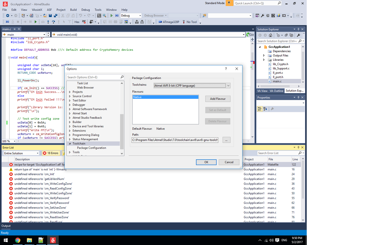

(#) david10 válasza rolandgw hozzászólására (») Máj 2, 2017 /
Nekem csak ezek jönnek elő:
(#) rolandgw válasza david10 hozzászólására (») Máj 2, 2017 / 1
Debug/GccApplication1 Properties.
Elindult, köszönöm szépen mindenkinek a segítséget!

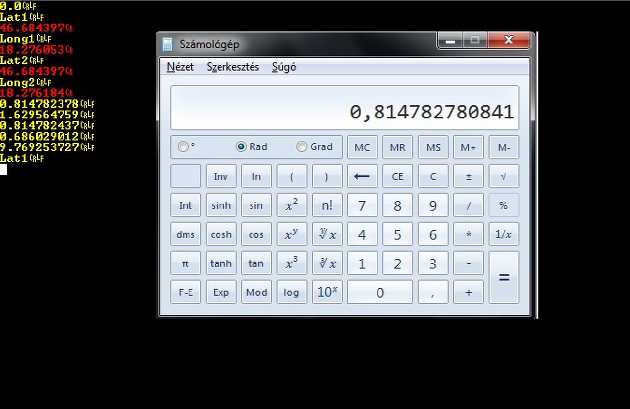

Sziasztok! Lehet inkább a kezdő topikba kellene feltennem a kérdést, de miért van az, hogy az AVR (attiny85) a 46.684397 és 0,017453 szorzásakor az reáltermen az alulról a 6. sort adja eredményül, miközben a helyes eredmény a számológépen látható, a változók single tip.
(#) csatti2 válasza pont hozzászólására (») Máj 3, 2017 /
A lebegőpontos számokkal való műveleteknek (szinte) mindig hibája van. Ennek oka, hogy véges felbontással tárolhatóak a lebegőpontos számok (olvass utána: exponens, mantissza). A 8 bites mikrokontrollerek ráadásul a legrosszabb pontosságú lebegőpontos számokat használják (single precision), de még azokkal is szoftveresen kalkulálnak (ezeket komolyabb ARM alapú uC-k gyakran hardveresen is támogatják).
Attól függően, milyen célúak a számítások, gyakran érdemesebb integer alapra áttenni a számításokat, hogy elfogadható pontosságú (és sebességű!) eredmény kapjál. Tipikus hiba: Rengeteg lebegőpontos szám összeadása, ahol az összeg folyamatosan egyre nagyobb lesz a hozzáadott értékhez képest (elképesztő hibát összehozhat ez).

(#) pont válasza csatti2 hozzászólására (») Máj 3, 2017 /
Köszönöm, de sajnos ez a rosszabb eset, hogy nem én rontottam el valamit...
Ha neked ez az eredmény nem elég jó, akkor te rontottad el. Nem a megfelelő eszközt használod a probléma megoldásához.
Persze igazad van, én arra gondoltam, hogy nem a számítás menetét rontottam el. (két gps koordináta távolságáról van szó). Melyik kontrollert ajánlanád ilyesmi számításokra, (szögfüggvények is vannak.)?
Tudomásom szerint az avrgcc csak 32bites lebegőpontos számításokat támogat, így inkább az ARM-ok felé kellene kacsingatnod.
(#) csabeszq válasza csatti2 hozzászólására (») Máj 5, 2017 /
Igazából jó lenne tudni, hogy AVR alatt minek kell 8 tizedes pontosság és miért nem elég a 32 bites float. A fenti képen látszik, hogy minden szép és jó, a 32 bit ezt tudja.
Azt írják, hogy az avr.h-ban le lehet cserélni, hogy a double 64 bites legyen.
Próbáld ki, hogy lecseréled 64-esre. Nálam most nincs gép.

(#) pont válasza csabeszq hozzászólására (») Máj 5, 2017 /
A GPS koordináták 8 tizedes pontosságban adják a milliméteres pontosságot. A fenti hibával az az érdekes helyzet állt elő, hogy a legegyszerűbb képlettel számolt koordináták közti távolságnál elvileg minél kisebb a távolság annál kisebb a hiba (mert nem számolunk a gömbölyűséggel) helyett minél nagyobb a távolság, százalékosan annál kisebb a hiba. Tehát pl. ha egy métert kellene mérni akkor csak 91cm-ert mér, ami ugye majd 10% hiba, ha 10 métert akkor 9.76-ot ami már csak 2,4% hiba és így tovább. Tehát ha nagyon kicsi számokkal kell számolnia akkor van "baj". Itt most azt kell elképzelni, hogy adott egy 6 millió méteres egyenlő szárú háromszög aminek az alapja 91 centi , és itt kell radiánban szögeket számolni.... Szóval tudomásul vettem, hogy AVR térképészethez kevés, de geocaching-re még jó lehet
(#) csabeszq válasza pont hozzászólására (») Máj 5, 2017 /
Kipróbáltad átírni az avr-gcc-t, hogy 64 biten működjön a double (lásd fentebb)? Nem látom, hogy miért ne tudna az AVR ilyet kiszámolni. C64-en is ment a 64 bites double C alatt.
A hozzászólás módosítva: Máj 5, 2017
(#) Kovidivi válasza pont hozzászólására (») Máj 5, 2017 /
"Szóval tudomásul vettem, hogy AVR térképészethez kevés" - ez kicsit durva. Nem az AVR hibája, hogy nem megfelelően van használva. Sima számolásról van szó. Ha egy 4 magos gép ki tudja számolni a koordinátát, akkor az AVR is ki tudja ugyanakkora pontossággal, csak esetleg lassabban. Tehát képes rá, csak tudni kell használni.
