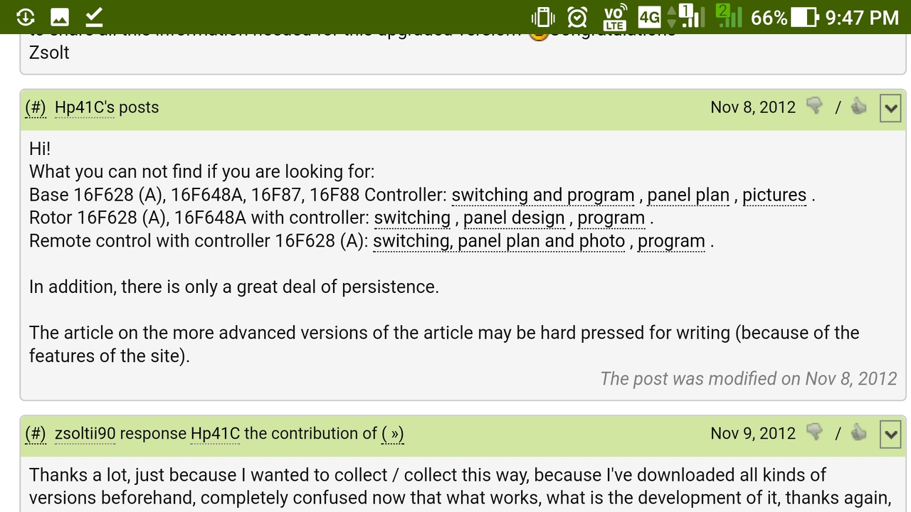

I am just searching and trying to studying the forum. And on page no. 283 (Nov. 8/2012), I found Base ,Rotor and Remote links with schematic, programming and pcb lay details. Is that all same that you provide me ? I am just asking because there are lay files. And I want to make pcb at home . Please reply .. Thanks... A hozzászólás módosítva: Feb 23, 2018
Engem érdekelne, ha felraknád a teljes projektet. Végre lenne egy müködő egyhelyre berakva.
Én is egyetértek nurseboy fórumtárs kérésével. Előre is köszi. Idézet: „Is that all same that you provide me ?” Thay seems to be the same. As You can see, all the pcbs or lay files where publicated by other conributors... I have no pcb for this version. I only built a base of this version with wire wrap tecnology. Since some parts are fashioned out (TSOP1736) the pcbs have to be modified at least to support the replacement part's pinout. As I can see all pcb linked use only one cupper layer, so they are ease to make with "home" technology.

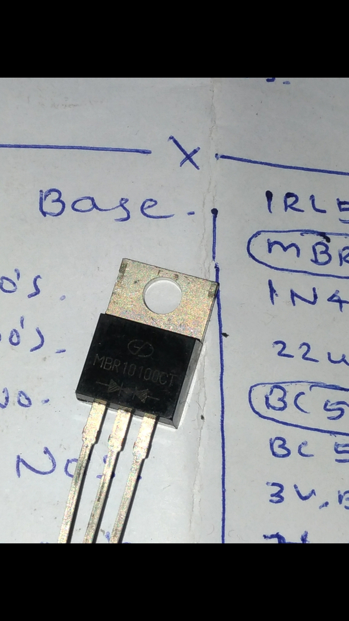

Thanks for replying. Ok,it means due to replacing some parts,pin out laying may be changed. No problem ,I will be managed it. Then can I go with it? One more thing, I got MBR10100CT with 3 legs. Can I use it instead of MBR10010? And LD274 ,BC639 and IRL530N are hard to getting here. So,is there equivalent part that I can use ? And is it compulsory to use SMD parts? Thanks again ...

The component selection may not have to be perfect match. Nearly all replacement can be used. (As You, we had to use parts wich we could get in Hungary 10 - 12 year before - or parts we already have.)
Diode on base (MBR10100CT) can be replaced with a Schottky diode min. 60 .. 100V and min. 2..3A. TO220 package gives a good cooling possibility. LD274 Ir LED: Can be replaced nearly any Ir LED but has a wave length mached with Ir phototransistor on the rotor. BC639: Can be replaced with any NPN transistor with Ic min. 1A. IRL530 used in two position: Driving the coil: Any Logic level N-MOSFET with Ud min. 100V and Ic min 8..10A Driving the relais: Any Logic level N-MOSFET or NPN transistor can be used if can switch the current of the relais coil.
