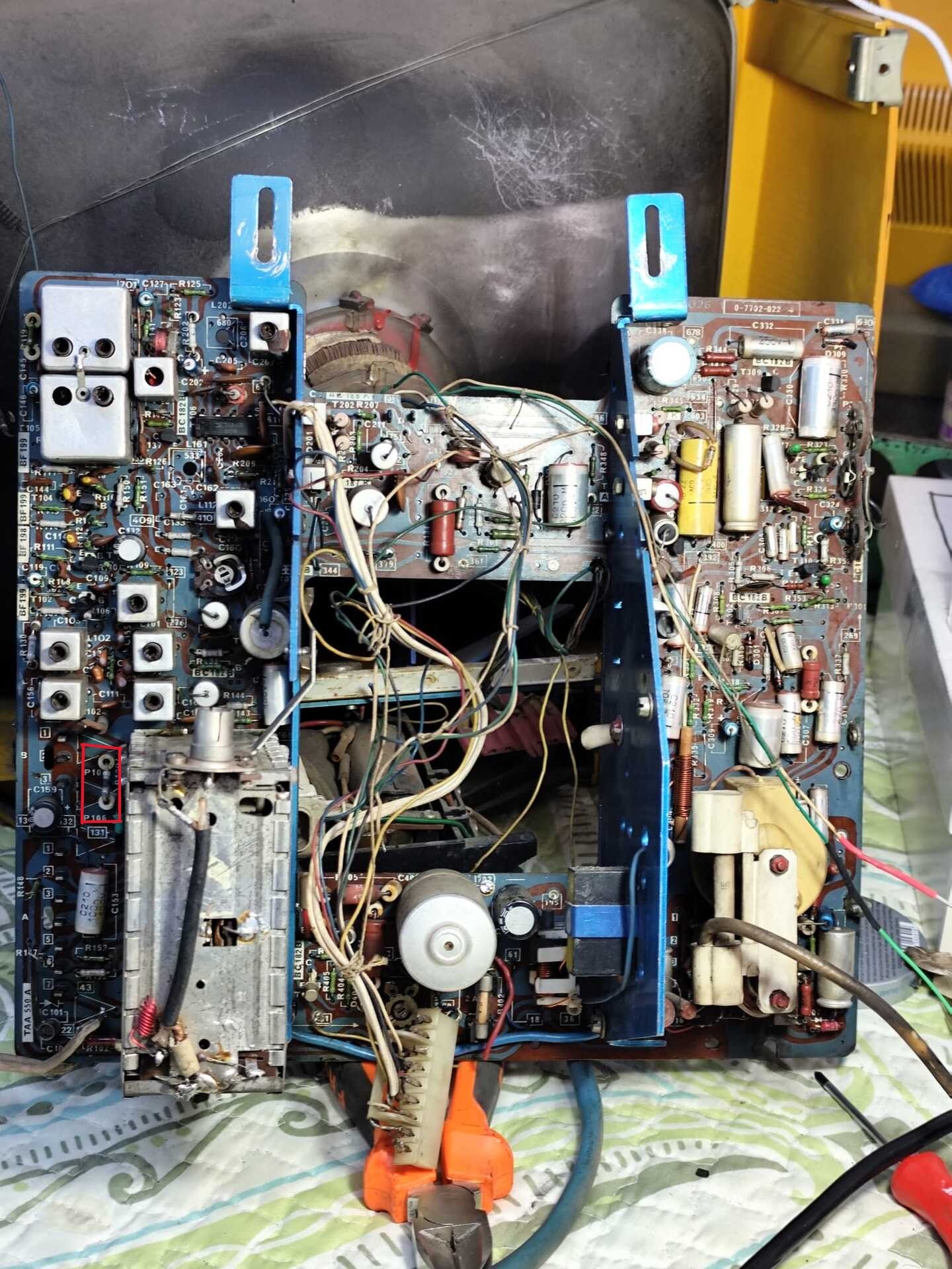

Hello everyone, I'm writing to you from Türkiye. I have a Hungarian-made Atlas TC-2610CU Videoton television that I bought about 35-40 years ago. This was my first television. It has some problems and I need the schematic of this TV. I want to leave you a link to show the TV type. I would appreciate your help with this. Thank you in advance.

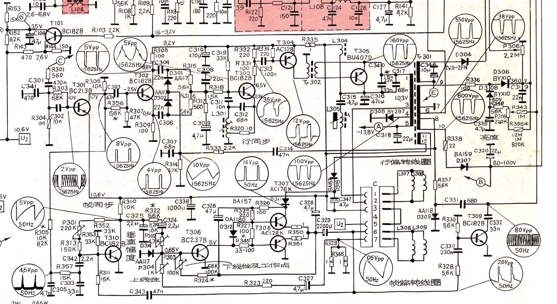

I found schematics of other models from the same company online. The TV is at my workplace right now, so I can't upload a picture. It's the same TV as in the link I provided. The problem is that there's only a horizontal line on the screen. So there seems to be a problem with vertical scanning. It seems to have been repaired before I bought it. The TV in the link looks perfectly fine with the back cover opened.

(#) Gafly válasza Rookie 1 hozzászólására (») 18:09 /
Do not use it as is, because in the future you will see this horizontal line (as black) permanently.
So vertical deflection is not working. Should not be a big problem, normally easy to fix.
When the equipment in your hand, we may suggest what to check, if needed.
(#) Rookie 1 válasza Gafly hozzászólására (») 18:13 /
I'm not near the TV right now. I'll send you the pictures when I get to work.
