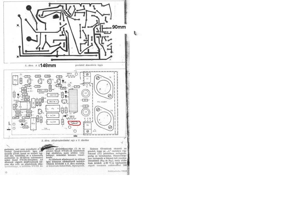

Good evening! Please, somebody tell what sizes in millimeters should have these printed-circuit boards. And radiator ( heatsink ) for installation on circuit board. Thanks.
Hi!
S.D.jpg attachment real pcb board size: horizontal: 148mm; vertical: 90mm.

I have collected almost all articles from the Hungarian magazines about this amplifier. But anywhere there are no sizes of printed-circuit boards. And on Hungarian language I unfortunately can't read. In your magazines printed-circuit boards in scale 1:1(i think). But I don't have possibility to get primary sources (magazines) in my Motherland.
I`m sorry, I wanted to write answer for magneto.
The google translator badly translated before.
I wanted to write this: "Here you are. This may be a starting point." I have attached to the my pcb board size: 138mm*84,2mm
