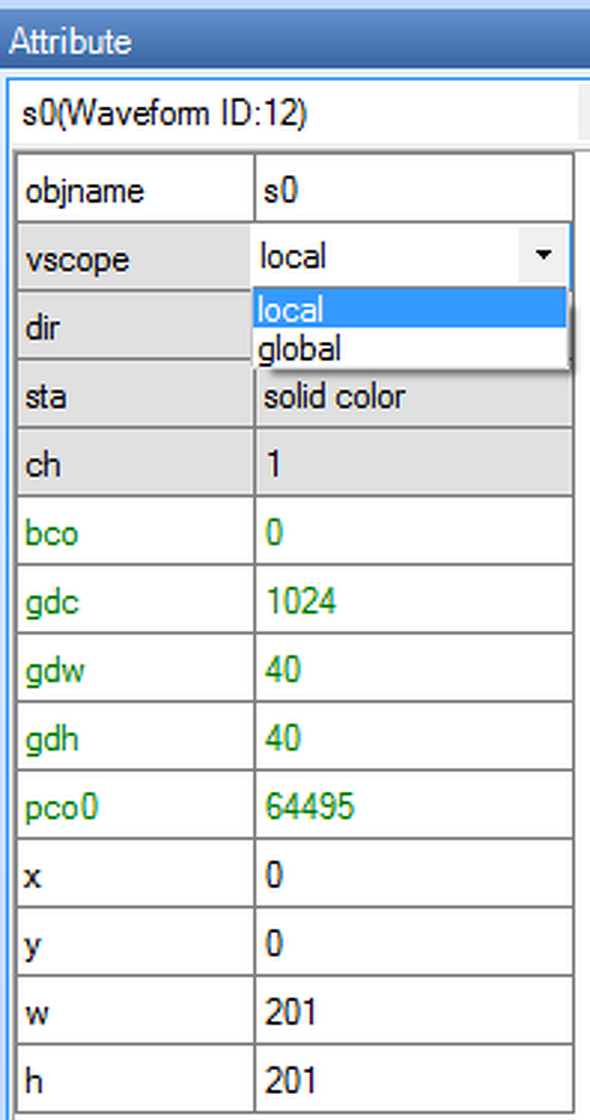

A waveform az hogy működik?
Hogyan tudok adatokat megadni neki amiket ki akarok rajzoltatni?
(#) Elektro.on válasza Lamprologus hozzászólására (») Máj 10, 2016 / 1
„add cmpID, ch, val
cmpID: Waveform component ID
ch: Waveform component channel number
val: value (maximum 255, minimum 0)
Example 1
add 1, 0, 30 //add data 30 to channel 0 of the Waveform component which ID number is 1
Example 2
add 1, 1, 50 //add data 50 to channel 1 of the Waveform component which ID number is 1
Remarks:
1.Waveform component only support 8-bit values, 0 minimum, 255 maximum.
2.Each page supports up to four Waveform components, each Waveform component supports up to four channels. It supports continuously pass through data, the component will auto-flow and display the value. It supports to change attributes during passing through data, such as change the background color or foreground color for each channel during the process.
De ha más lapra mész nullázza ha nem teszed globálissá az elemet. Kép lent.
