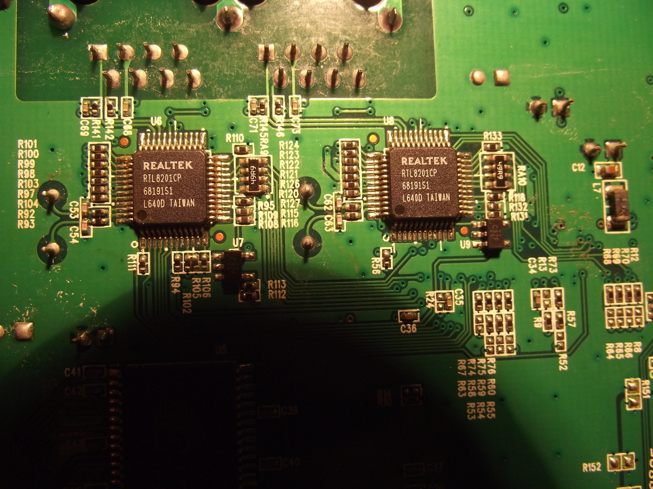

Beleszaladtam egy érdekes hibába. Van egy Airlive WL-5460AP router ami nem hajlandó elindulni. Némi ujjgyakorlat után a terminál az alábbiakat adta: Idézet: „Jump to image start=0x80800000... early printk enabled Determined physical RAM map: memory: 01000000 @ 00000000 (usable) Initial ramdisk at: 0x801aa000 (6144000 bytes) On node 0 totalpages: 4096 zone(0): 4096 pages. zone(1): 0 pages. zone(2): 0 pages. Kernel command line: root=/dev/ram console=0 ramdisk_start=0 single Calibrating delay loop... 178.99 BogoMIPS Memory: 8280k/16384k available (1504k kernel code, 8104k reserved, 6128k data, 52k init, 0k highmem) Dentry-cache hash table entries: 2048 (order: 2, 16384 bytes) Inode-cache hash table entries: 1024 (order: 1, 8192 bytes) Mount-cache hash table entries: 512 (order: 0, 4096 bytes) Buffer-cache hash table entries: 1024 (order: 0, 4096 bytes) Page-cache hash table entries: 4096 (order: 2, 16384 bytes) check_wait... unavailable. POSIX conformance testing by UNIFIX Linux NET4.0 for Linux 2.4 Based upon Swansea University Computer Society NET3.039 Initializing RT netlink socket Starting kswapd Serial driver version 6.02 (2003-03-12) with no serial options enabled ttyS00 at 0x00c3 (irq = 3) is a rtl_uart1 state->flags=00000000 Realtek GPIO Driver for Flash Reload Default block: 64 slots per queue, batch=16 RAMDISK driver initialized: 16 RAM disks of 6200K size 1024 blocksize PPP generic driver version 2.4.1 RealTek E-Flash System Driver. (C) 2002 RealTek Corp. Found 1 x 2M Byte MXIC MX29LV160AB at 0xbe000000 RTL8180/RTL8185 driver version 1.7 (2005-05-13) 8186NIC Ethernet driver v0.0.2 (Jan 30, 2004) eth0: RTL8186-NIC at 0xbd200000, 00:01:02:03:04:05, IRQ 4 eth1: RTL8186-NIC at 0xbd300000, 04:05:06:07:08:09, IRQ 5 NET4: Linux TCP/IP 1.0 for NET4.0 IP Protocols: ICMP, UDP, TCP, IGMP IP: routing cache hash table of 512 buckets, 4Kbytes TCP: Hash tables configured (established 1024 bind 2048) ip_conntrack version 2.1 (128 buckets, 1024 max) - 300 bytes per conntrack ip_tables: (C) 2000-2002 Netfilter core team NET4: Unix domain sockets 1.0/SMP for Linux NET4.0. NET4: Ethernet Bridge 008 for NET4.0 RAMDISK: ext2 filesystem found at block 0 RAMDISK: Loading 6000 blocks [1 disk] into ram disk... done. Freeing initrd memory: 6000k freed VFS: Mounted root (ext2 filesystem). Freeing unused kernel memory: 52k freed mount /proc file system ok! serial console detected. Disabling virtual terminals. init started: BusyBox v1.00-pre8 (2006.01.09-05:26+0000) multi-call binary BusyBox v1.00-pre8 (2006.01.09-05:26+0000) Built-in shell (msh) Enter 'help' for a list of built-in commands. HW configuration invalid, reset default! eth0 rx error =4 eth0 rx error =4 eth0 rx error =4 . . . ” Tehát gyakorlatilag minden ok, kivéve, hogy az eth0-val nem tud kommunikálni és itt meg is áll a tudomány... Van 2db RTL8201CP ami köszül szerintem az egyik rossz, praktikusan az eth0-hoz tartozó. Szerintem. Van esetleg valakinek ötlete, hogy merre induljak? Kép mellékelve, szerintem a bal oldali az eth0.
Van neki valamilyen firmware recovery módja, nekem még soha nem sikerült elindítani azt. Nem egy mai AP, borzasztó lassú a szoftvere, mindenért reboot-ot kér, érzékenyek a LAN portjai. Egyébként nem biztos, hogy fizikai hiba miatt nem működik az eth0, ugyan is, el van piszkálva a MAC címe. Pl. az 5400CPE csak a saját, beépített miniPCI kártyájával hajlandó működni, hiába teszed át egy ugyan olyanból. Próbáld meg azt a recovery módot, hát ha te sikerrel jársz.
Recovery módba be sem lép, idáig jut:
Idézet: „ UART1 output test ok Uart init mfid=000000c2 devid=00002249 Found 1 x 2M flash memory ---RealTek(RTL8186)at 2006.02.16-18:47+0800 version 1.4 [16bit](180MHz) no sys signature at 00010000! ---Escape booting by user ” és innen nem hajlandó tovább menni. Itt elméletileg meg kellene jelenni egy "command prompt"-nak ahova lehetne utasításokat irkálni. Abból gondolom, hogy hardware hiba lehet, mivel ha a 0-s portba dugok kábelt nem történik semmi, ha az 1-esbe akkor világít a port ledje.
Ha van hőléged akkor cseréld meg a két IC-t.
Köszi, ha lenne már megtettem volna...
Ha más ötlet nincs, majd keresek valakit aki meg tudja cserélni... Igazából ez aggaszt : Idézet: „HW configuration invalid, reset default!”
Az SDK-ból származó alapokon valszínűleg nem változtattak sokmindent:
https://github.com/KrabbyPatty/rtl819x-toolchain/blob/master/users/...tup.sh A problémás sort azért kapod mert lefuttatja a flash binárist a test-hwconf argumentummal. Majd mivel ez elbukik meghívja a flash default parancsot. Ez a flash bináris valószínűleg valami zárt forráskódú tool, így nem fogjuk megtudni mit is csinál konkrétan. De ha a link status LED sem működik a 0. porton akkor ott HW hiba lesz 99.9999%. A hozzászólás módosítva: Dec 7, 2014
Utánanéztem kicsit, de már nem engedte módosítani.
flash forrása itt: http://pastebin.com/meZtSKrz (Valaki volt oly jó és feltette a google meg ügyesen indexelte.) A funkció a apmib_hwconf() függvényt hívja. Annak forrása itt. Ethernet porthoz itt nem hiszem hogy nyúl, cserébe a flashből olvas fel tömörített adatokat. Sok helyen van return NULL -ami a flash test-hwconf -1-el való visszatérését okozza- ám intelligens módon a hibainfók printfelése ki van kommentelve. Egy szó mint száz a flashtartalommal sincs valami rendben. Gondolom az a port döglött le amin újra lehet flashelni?
Köszi az utánajárást!
A 0-s porton lehetne flashelni, de minthogy döglött, nem jut el odáig. Ha majd ki tudom cserélni a két 8201cp-t beszámolok az eredményről...
