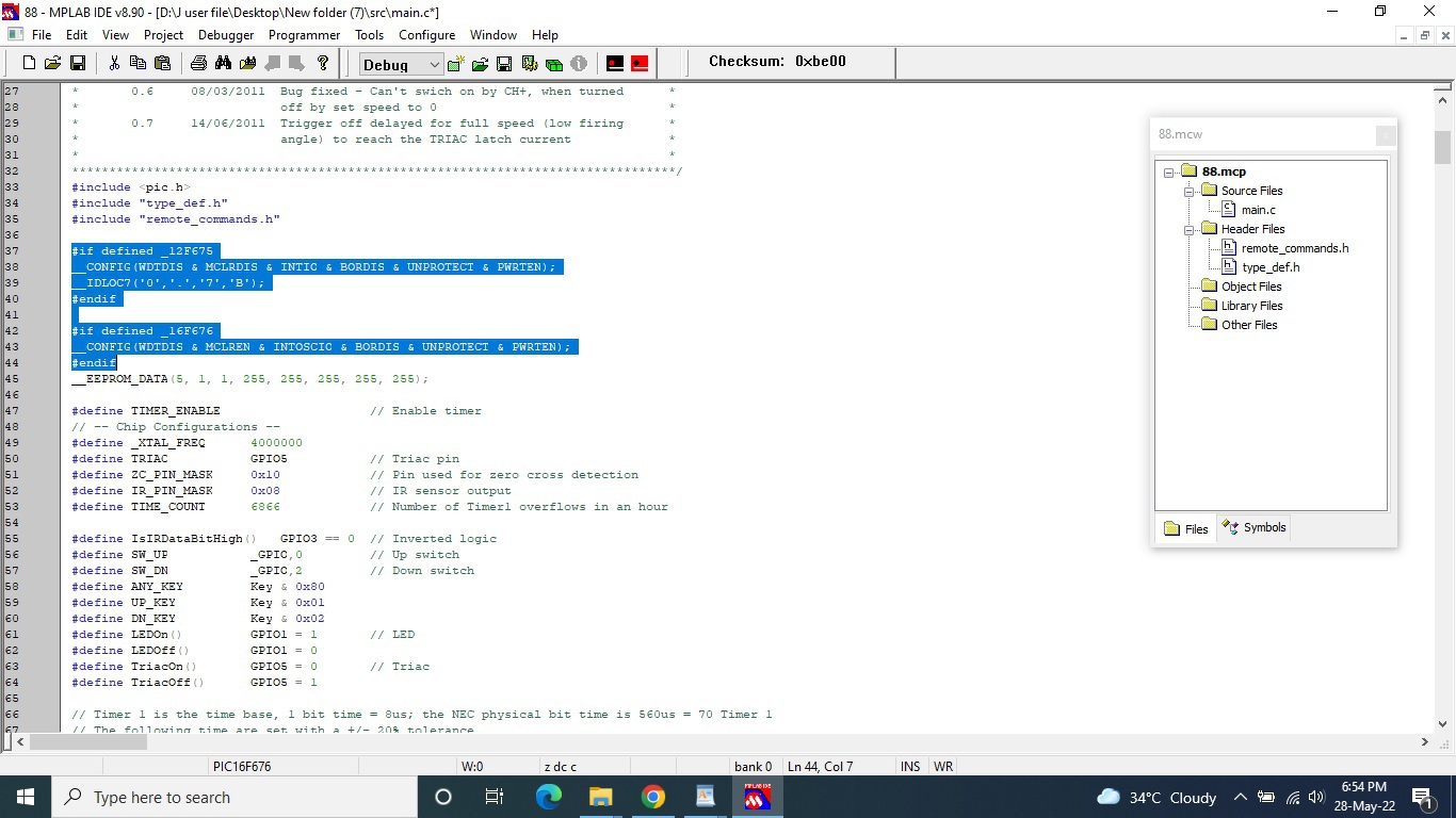

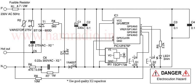

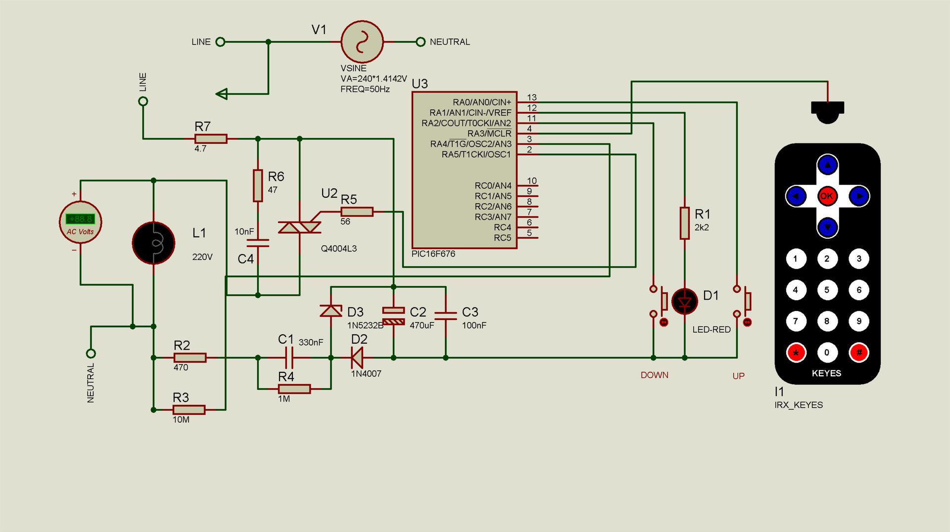

(#) Naresh Jain hozzászólása Máj 27, 2022 /
Hi friends, I NEED YOUR HELP, I have fan controller circuit with diagram and codes using microcontroller PIC12F675, circuit works successfully on hardware,now I want to use PIC16F676 inplace of PIC12F675 and need to changes in codes for PIC16F676, schematic and source codes files attached here:

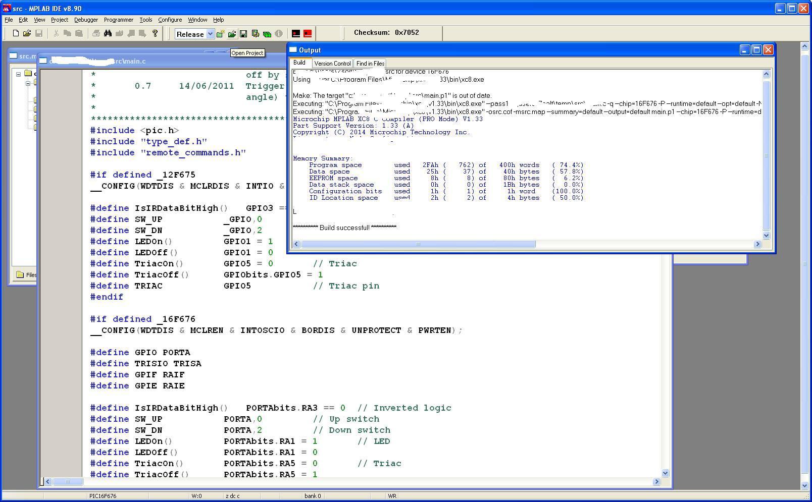

(#) Hp41C válasza Naresh Jain hozzászólására (») Máj 27, 2022 /
Hi,
Since 16F676 has PORTA/TRISA registers put some define lines into conditional blocks.
  1. #if defined _12F675
  2. __CONFIG(WDTDIS & MCLRDIS & INTIO & BORDIS & UNPROTECT & PWRTEN);
  3.
  4. #define IsIRDataBitHigh()   GPIO3 == 0  // Inverted logic
  5. #define SW_UP           _GPIO,0         // Up switch
  6. #define SW_DN           _GPIO,2         // Down switch
  7. #define LEDOn()         GPIO1 = 1       // LED
  8. #define LEDOff()        GPIO1 = 0
  9. #define TriacOn()       GPIO5 = 0       // Triac
  10. #define TriacOff()      GPIObits.GPIO5 = 1
  11. #define TRIAC           GPIO5           // Triac pin
  12. #endif
  13.
  14. #if defined _16F676
  15. __CONFIG(WDTDIS & MCLREN & INTOSCIO & BORDIS & UNPROTECT & PWRTEN);
  16.
  17. #define GPIO PORTA
  18. #define TRISIO TRISA
  19. #define GPIF RAIF
  20. #define GPIE RAIE
  21.
  22. #define IsIRDataBitHigh()   PORTAbits.RA3 == 0  // Inverted logic
  23. #define SW_UP           PORTA,0         // Up switch
  24. #define SW_DN           PORTA,2         // Down switch
  25. #define LEDOn()         PORTAbits.RA1 = 1       // LED
  26. #define LEDOff()        PORTAbits.RA1 = 0
  27. #define TriacOn()       PORTAbits.RA5 = 0       // Triac
  28. #define TriacOff()      PORTAbits.RA5 = 1
  29. #define TRIAC           PORTAbits.RA5           // Triac pin
  30. #endif
  31.
  32. __IDLOC7('0','.','7','B');
The IC locations can be set out of conditional block
(#) Naresh Jain válasza Hp41C hozzászólására (») Máj 28, 2022 /
Dear sir, I don't know how to change in codes, I simply copy and paste the above said code but not success, I request you please make the changes in attached src file here :
src.rar
(#) Hp41C válasza Naresh Jain hozzászólására (») Máj 28, 2022 /
Modification made by replacing lines 37-44 in Your main.c with the lines uploaded.
It can be compiled with old MpLab 9.xx and XC8 1.3x.

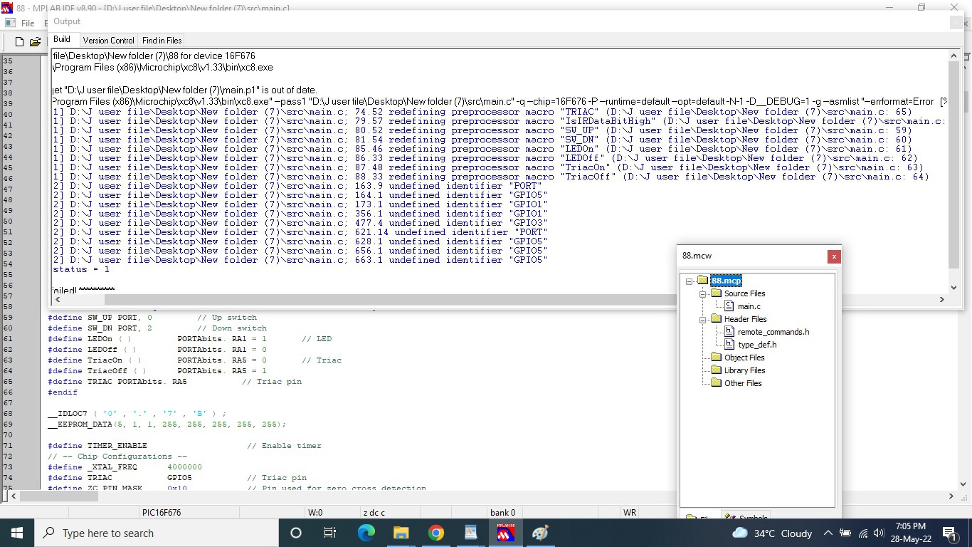

Dear sir ,screen shot of 37-44 attached here,I replaced the marked codes with codes upload by you and compiled in xc8 1.33 but received error,error screen shot also attached,I think I made mistake:
A hozzászólás módosítva: Máj 28, 2022
My version of main.c could be compiled....
(#) pipi válasza Naresh Jain hozzászólására (») Máj 28, 2022 /
and remove spaces
(#) Naresh Jain válasza Hp41C hozzászólására (») Máj 29, 2022 /
Thank you very much Mr. Hp41C and Mr. pipi for your support, I compiled the code successfully as you define, but I faced a problem ,I simulate the circuit in proteus of 12f675 with previous code successfully but the circuit with 16f676 with new genrated code not simulate in proteus,both proteus files,screen shot and hex attached here ;
A hozzászólás módosítva: Máj 29, 2022

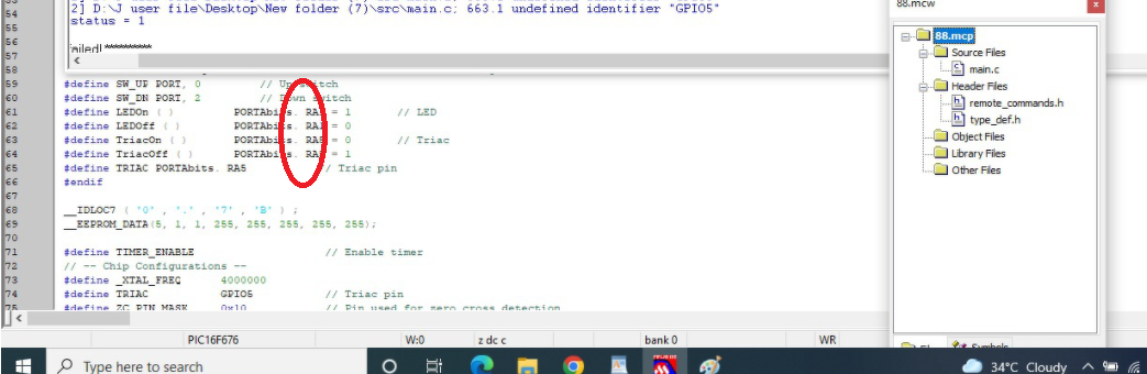

(#) Hp41C válasza Naresh Jain hozzászólására (») Máj 29, 2022 /
In Your configuration settings for 12F625 conatins MCLRDIS but settings for 12F676 conatins MLCRLEN. Change it to MCLRDIS since RA3 is the output of IR receiver.
THANK YOU VERY MUCH Mr. Hp41C,

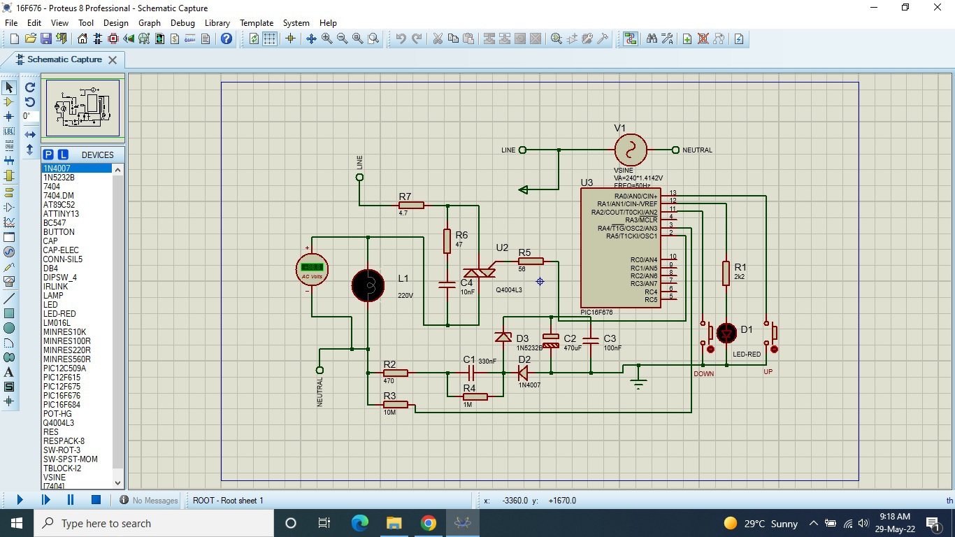

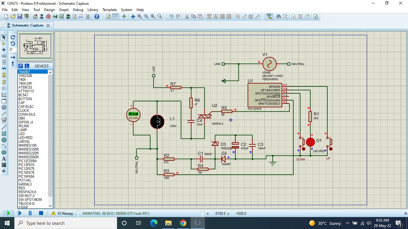

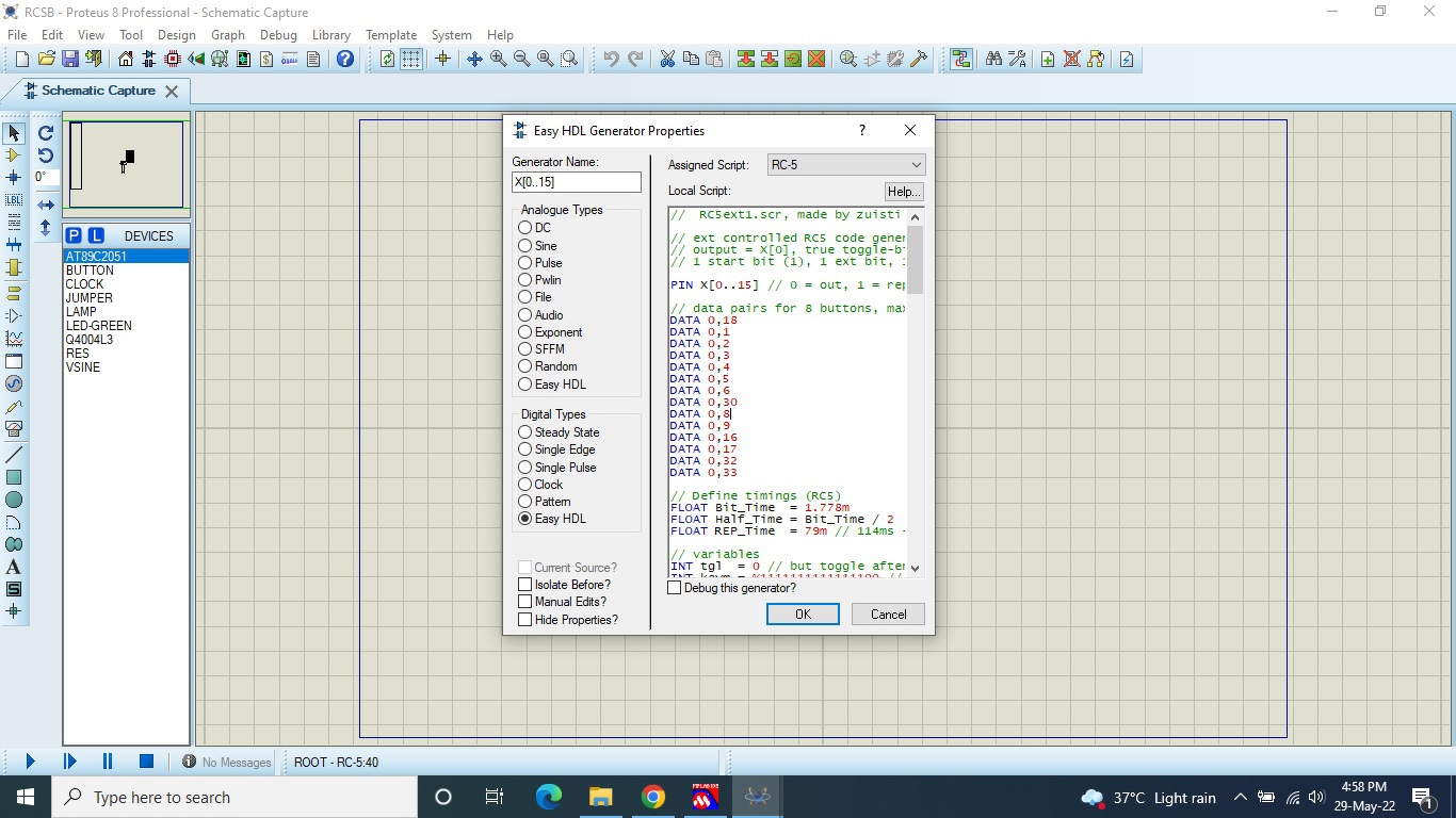

Dear sir, I simulate the circuit with 16f676 successfully in proteus,
One more question please, can I test with ir remote in proteus, it has ir nec protocol, I have not ir nec transmitter in proteus,but I have Rc5 EasyHDL script generator,it can generate rc commands,easyhdl rc5 code attached,kindly make changes it for nec protocol;
  1. //  RC5ext1.scr, made by zuisti (Istvan K (c) copyright 2015)

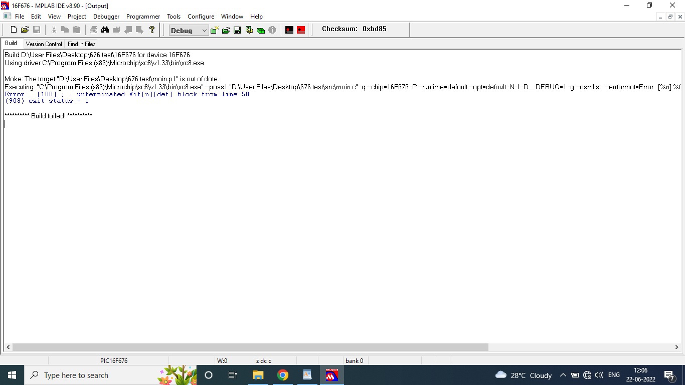

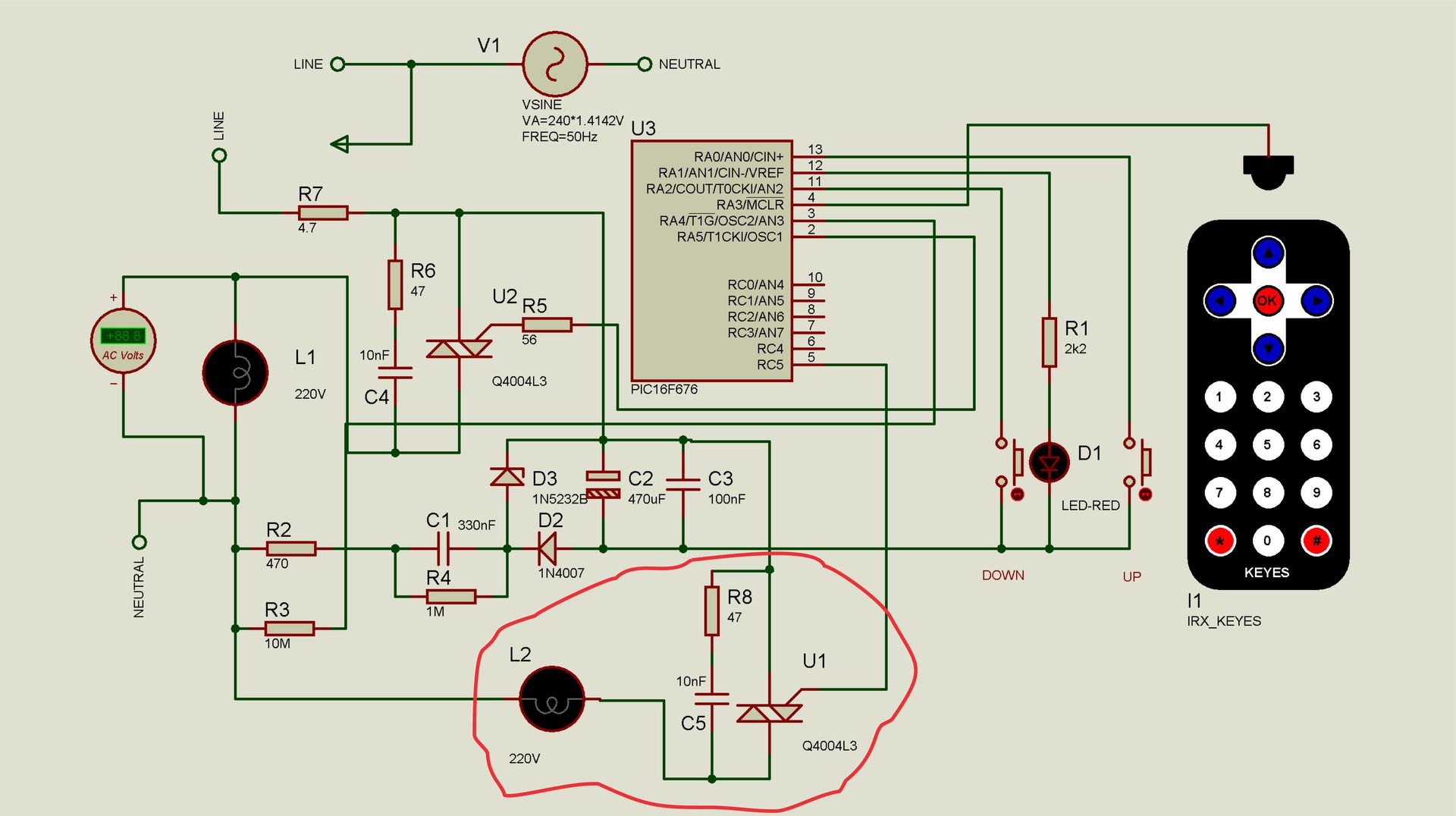

(#) Naresh Jain válasza Hp41C hozzászólására (») Jún 21, 2022 /
Dear Sir, I need your help again, I have the codes to control the traic to control the speed of fan using 16F676 schematic 1 working successfully and codes attached below, now I want some amendment in codes to toggle control one more triac on another port as schematic 2 attached below, Please help me

what will change in codes:
(#) Hp41C válasza Naresh Jain hozzászólására (») Jún 21, 2022 /
Hi,
first you need to find two IR command codes not used yet by the program. Found a list of NEC IR keycodes with CH, CH100 and CH200 codes.
Add these codes to the list "in remote_commands.h".
  1. CH100         = 0x19,     // triac2 on
  2.     CH200         = 0x0D      // triac2 off
Put theses defines next to "#define TRIAC PORTAbits.RA5 // Triac pin"
  1. #define Triac2On()      PORTCbits.RC5 = 0       // Triac2
  2.     #define Triac2Off()     PORTCbits.RC5 = 1
  3.     #define TRIAC2          PORTCbits.RC5           // Triac2 pin
Extend the initializatiion with clearing PORTC and TRISC registers:
  1. void main(void)
  2.     {
  3.         #asm
  4.             call    0x3ff
  5.                     bsf             STATUS, 5
  6.                     movwf   OSCCAL & 0x7f
  7.                     bcf             STATUS, 5
  8.         #endasm
  9.         GPIO    = 0;                                        // Clear PORT
  10.         PORTC   = 0;
  11.         TriacOff();                                         // Triac off
  12.         TRISIO  = ZC_PIN_MASK | IR_PIN_MASK | 0x05;         // IR, Zero cross and swiches
  13.         TRISC   = 0x00;
Add two block to IRHandler function before default label:
  1. case CH100:
  2.                         Triac2On();
  3.                         break;
  4.
  5.                         case CH200:
  6.                         Triac2Off();
  7.                         break;
A hozzászólás módosítva: Jún 21, 2022

(#) Naresh Jain válasza Hp41C hozzászólására (») Jún 22, 2022 /
Sir I failed to compile with this main.c, I think I made some mistakes,screen shot attached :
