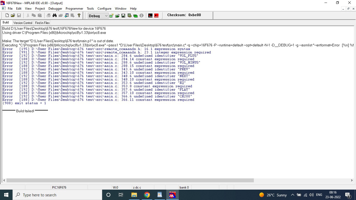

(#) Naresh Jain válasza Hp41C hozzászólására (») Jún 23, 2022 /
sir, I tried to make hex but not success,screen shot attached,please solve the issue ;
A hozzászólás módosítva: Jún 23, 2022
(#) Hp41C válasza Naresh Jain hozzászólására (») Jún 23, 2022 /
Hi,
Expression syntax error in remote_commans.h line 16:
What is missing from the declaration of typedef enum _IR_COMMAND?
.. Oh yes, the commas from CH100 and CH200 lines.
Ok, please upload the modified main.c
Yes sir, I inserted the comma's in remote commands now, I successfully compiled the codes and generated hex, but not test it yet on hardware,
THANK YOU HP41C SIR,

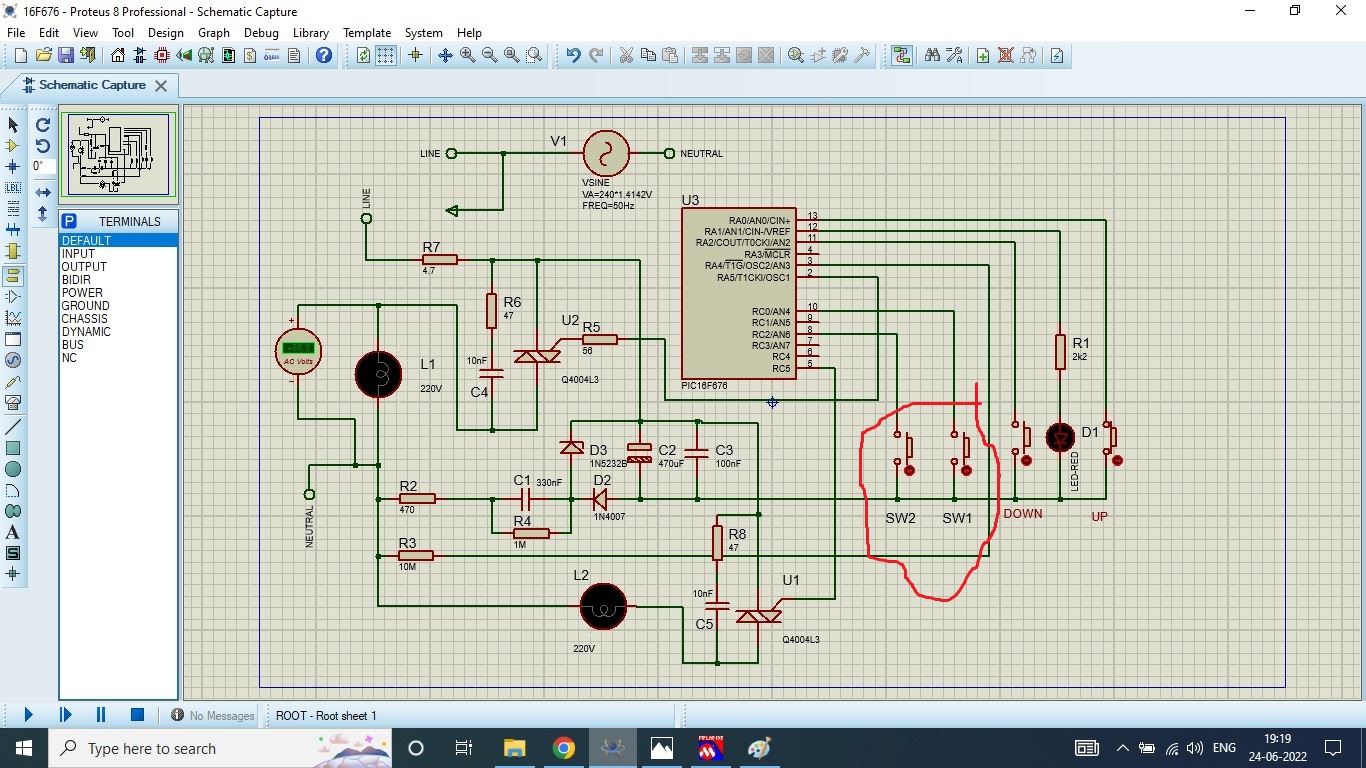

(#) Naresh Jain válasza Hp41C hozzászólására (») Jún 24, 2022 /
Dear friend, hardware testing is time taking and little hard job and remote in proteus is not functioning perfectly, please let me know if we attached two toggle swiches on free port as shown in attached screen shot,port RC0 SW1 is for ON and port RC2 SW2 is for OFF for triac2, then what ia modification in codes in main.c, if it is possible then i can test in proteus simulation software,
PLEASE MODIFY THE CODES:
