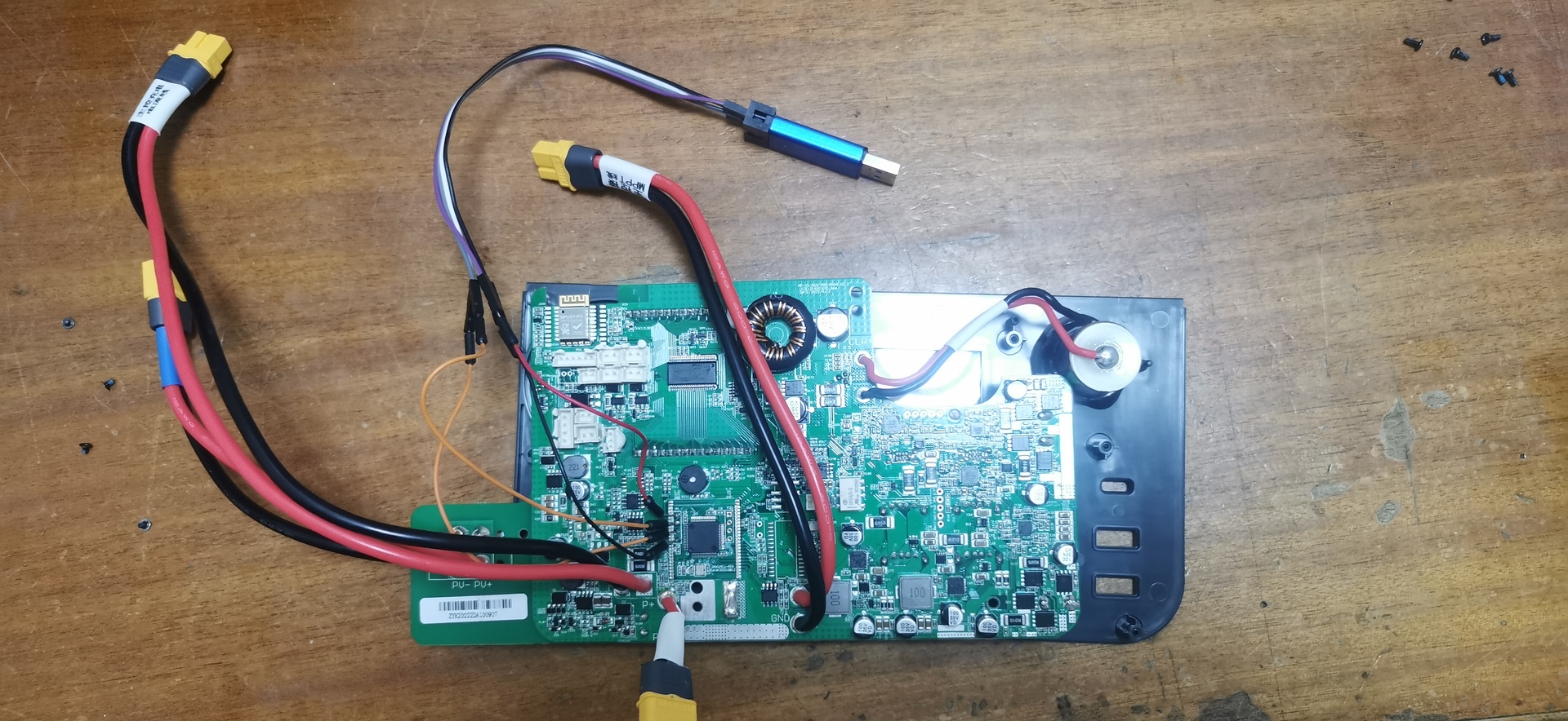

(#) zaza99 hozzászólása Feb 10, 2025 /
N32G455 égetés hiba
N32G455 chipet szeretnék flashelni meglévő tartalommal. .mot . bin fájlok vannak.
Egy Kék ST-Link-et sikerült j-Linkre flasselni.
A kapcsolat sikeresen létrejön STM32G431RB mag választásával.
A rom és a rom_plus sikeresen olvasható. A flash tiltott az option meg csak egy szóközökből álló állományt hoz létre.
  1. SEGGER J-Link Commander V7.96e (Compiled Apr 17 2024 16:26:32)
  2. DLL version V7.96e, compiled Apr 17 2024 16:25:43
  3.
  4. Connecting to J-Link via USB...O.K.
  5. Firmware: J-Link STLink V2 compiled Aug 12 2019 10:28:03
  6. Hardware version: V1.00
  7. J-Link uptime (since boot): N/A (Not supported by this model)
  8. S/N: 779982069
  9. VTref=3.300V
  10.
  11.
  12. Type "connect" to establish a target connection, '?' for help
  13. J-Link>connect
  14. Please specify device / core. <Default>: STM32G431RB
  15. Type '?' for selection dialog
  16. Device>
  17. Please specify target interface:
  18.   J) JTAG (Default)
  19.   S) SWD
  20.   T) cJTAG
  21. TIF>s
  22. Specify target interface speed [kHz]. <Default>: 4000 kHz
  23. Speed>
  24. Device "STM32G431RB" selected.
  25.
  26.
  27. Connecting to target via SWD
  28. InitTarget() start
  29. SWD selected. Executing JTAG -> SWD switching sequence.
  30. DAP initialized successfully.
  31. Skipping protection check. Reason: Unexpected DEV_ID found:0x00000511
  32. InitTarget() end - Took 12.3ms
  33. Found SW-DP with ID 0x4BA01477
  34. DPv0 detected
  35. CoreSight SoC-400 or earlier
  36. Scanning AP map to find all available APs
  37. AP[1]: Stopped AP scan as end of AP map has been reached
  38. AP[0]: AHB-AP (IDR: 0x24770011)
  39. Iterating through AP map to find AHB-AP to use
  40. AP[0]: Core found
  41. AP[0]: AHB-AP ROM base: 0xE00FF000
  42. CPUID register: 0x410FC241. Implementer code: 0x41 (ARM)
  43. Found Cortex-M4 r0p1, Little endian.
  44. FPUnit: 6 code (BP) slots and 2 literal slots
  45. CoreSight components:
  46. ROMTbl[0] @ E00FF000
  47. [0][0]: E000E000 CID B105E00D PID 000BB00C SCS-M7
  48. [0][1]: E0001000 CID B105E00D PID 003BB002 DWT
  49. [0][2]: E0002000 CID B105E00D PID 002BB003 FPB
  50. [0][3]: E0000000 CID B105E00D PID 003BB001 ITM
  51. [0][4]: E0040000 CID 00000000 PID 00000000 ???
  52. [0][5]: E0041000 CID B105900D PID 000BB925 ETM
  53. Memory zones:
  54.   Zone: "Default" Description: Default access mode
  55. Cortex-M4 identified.
  56. J-Link>loadfile c:\allpowers_2000.mot
  57. 'loadfile': Performing implicit reset & halt of MCU.
  58. Reset: Halt core after reset via DEMCR.VC_CORERESET.
  59. Reset: Reset device via AIRCR.SYSRESETREQ.
  60. Downloading file [c:\allpowers_2000.mot]...
  61.
  62. ****** Error: Programming failed (error code = 4) for block @ address 0x08000000 (2048)
  63. Writing target memory failed.
  64. J-Link>mem 0x00 0x200
  65. Could not read memory.
  66. J-Link>
Tudnátok segíteni?
Van arduino unom, nanon meg egy Blue pill is ha esetleg kell
(#) B0nsh44 válasza zaza99 hozzászólására (») Feb 11, 2025 /
Még nem volt szerencsém találkozni ezzel a mikrovezérlővel.
"Egy Kék ST-Link-et sikerült j-Linkre flasselni."
- A SEGGER J-Flash Lite v8.12 támogatja a csippet.
Ha szeretsz parancssorból programozni akkor egy "Blue pill" -ből CMSIS-DAP adaptert csinálni, és a PYOCD szintén támogatja a csippet.
- "pyocd pack install N32G455"
A csip saját bootloaderének használata.
Az adatlap szerint van fix boot loader, ehez kellene "nations mcu download tool" amihez nem találtam élő letöltési linket.
(#) B0nsh44 válasza B0nsh44 hozzászólására (») Feb 11, 2025 /
Nem hagyot nyugodni a dolog, csak találtam letölthető tool -t. Bővebben: Link
(#) zaza99 válasza B0nsh44 hozzászólására (») Feb 11, 2025 /
CMSIS-DAP adaptert csak még egy Blue pill-ből tudok felprogramozni?
Jelenleg csak egy Blue pill-em van meg 2 ST-linkem /Egyik J-linkre flaselve/ meg arduino unom van.
A hozzászólás módosítva: Feb 11, 2025
