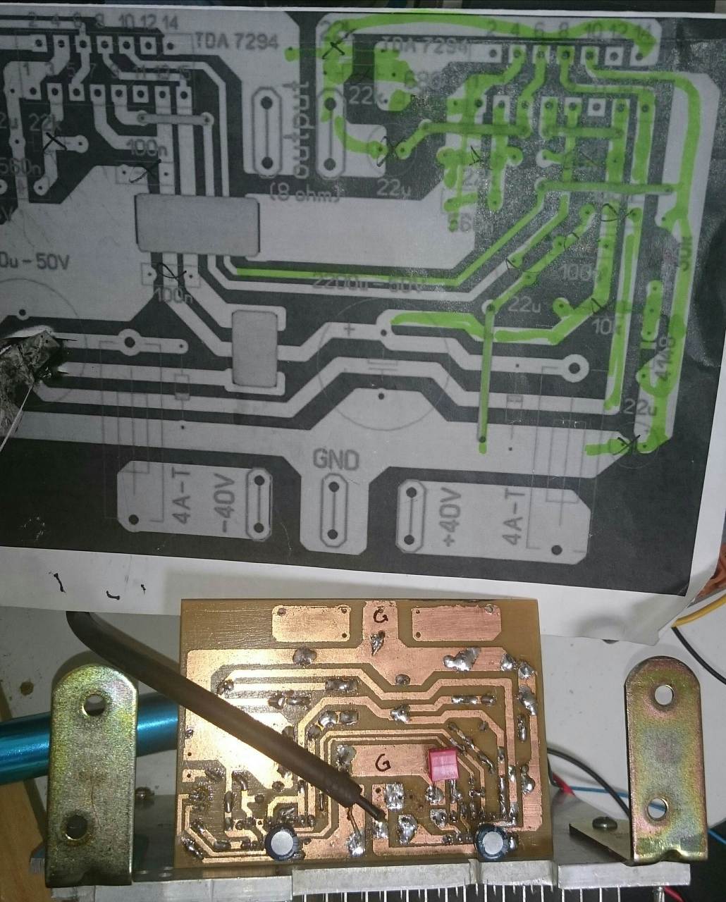

(#) Awa hozzászólása Ápr 16, 2017 /
Hello from Canary Islands ,Spain.
Hope some one can helpme with this.
After browse for many pcb's for TDA in BTL I decide to make this one posted here,
http://www.hobbielektronika.hu/forum/topic_post_1147538.html#1147538
due its have few tracks betwen IC pins, and good thickness.
Well dedigned in general.
I use TDA7293, changing bootstrap capacitors from pins 6-14 to 6-12 in booth IC.
I'm using a +46 o -46 around 5A power source, initially I test it with a 40w lamp in series with the transformer.
It don't work. Im only get high beep... with full voltage, only work with about 12v, or when capacitor are charging or discharging.
I try testing only the IC at the left (audio input) connecting the speaker between ground and pin 14 of this IC and it works at full voltage.
But when I test with the IC at the right is make "tuck..." and then nothing until I disconnect the power.
IC replaced with the same results.
Tracks and solderings checked.
I don't have more ideas about what is wrong.
Hope someone can helpme..
Many thanks.
(#) Cinema válasza Awa hozzászólására (») Ápr 17, 2017 /
Hi!
This Board Not Good.
Download the "Original" Datasheet the TDA7293, or 7294 For Bridge-Operation.
Isolated the Heatsink-to-TDA!
New Components Recommended the Good Work.
Good Luck!
