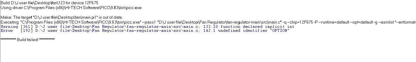

error is attached here:
(#) Hp41C válasza Naresh Jain hozzászólására (») Aug 14, 2021 / 2
Line 133 of main.c: READ_OSCCAL_DATA() not defined function taken a function returning one integer value. Has to be defined somewhere.
Line 142 of main.c: OPTION not defined symbol. The symbol of OPTION register is OPTION_REG.

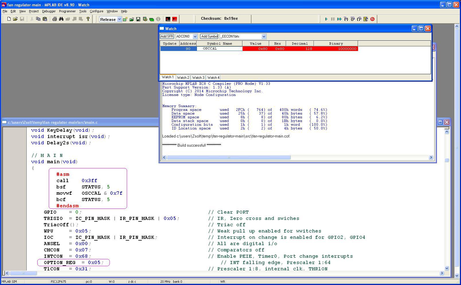

(#) Hp41C válasza Naresh Jain hozzászólására (») Aug 15, 2021 / 2
Hi,
the line 142 of main.c should be modified to:
  1. OPTION_REG  = 0x05;                                     // INT falling edge, Prescaler 1:64
Since READ_OSCCAL_DATA() not devined it should be replaced with code form datasheet.
  1. #asm
  2.         call    0x3ff
  3.                 bsf             STATUS, 5
  4.                 movwf   OSCCAL
  5.                 bcf             STATUS, 5
  6.         #endasm
If the retlw instruction at the last address of program memory not kept the program vill not start.

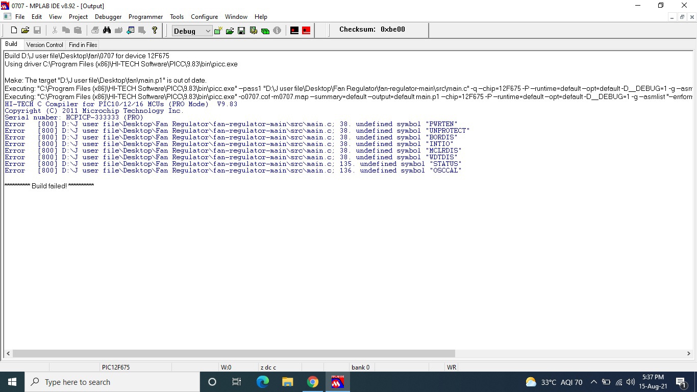

Dear I change the code as you said,then some errors appears :
Build D:\J user file\Desktop\fan\0707 for device 12F675
Using driver C:\Program Files (x86)\HI-TECH Software\PICC\9.83\bin\picc.exe
Make: The target "D:\J user file\Desktop\fan\main.p1" is out of date.
Executing: "C:\Program Files (x86)\HI-TECH Software\PICC\9.83\bin\picc.exe" --pass1 "D:\J user file\Desktop\Fan Regulator\fan-regulator-main\src\main.c" -q --chip=12F675 -P --runtime=default --opt=default -D__DEBUG=1 -g --asmlist "--errformat=Error [%n] %f; %l.%c %s" "--msgformat=Advisory[%n] %s" "--warnformat=Warning [%n] %f; %l.%c %s"
Executing: "C:\Program Files (x86)\HI-TECH Software\PICC\9.83\bin\picc.exe" -o0707.cof -m0707.map --summary=default --output=default main.p1 --chip=12F675 -P --runtime=default --opt=default -D__DEBUG=1 -g --asmlist "--errformat=Error [%n] %f; %l.%c %s" "--msgformat=Advisory[%n] %s" "--warnformat=Warning [%n] %f; %l.%c %s"
HI-TECH C Compiler for PIC10/12/16 MCUs (PRO Mode) V9.83
Copyright (C) 2011 Microchip Technology Inc.
Serial number: HCPICP-333333 (PRO)
Error [800] D:\J user file\Desktop\Fan Regulator\fan-regulator-main\src\main.c; 38. undefined symbol "PWRTEN"
Error [800] D:\J user file\Desktop\Fan Regulator\fan-regulator-main\src\main.c; 38. undefined symbol "UNPROTECT"
Error [800] D:\J user file\Desktop\Fan Regulator\fan-regulator-main\src\main.c; 38. undefined symbol "BORDIS"
Error [800] D:\J user file\Desktop\Fan Regulator\fan-regulator-main\src\main.c; 38. undefined symbol "INTIO"
Error [800] D:\J user file\Desktop\Fan Regulator\fan-regulator-main\src\main.c; 38. undefined symbol "MCLRDIS"
Error [800] D:\J user file\Desktop\Fan Regulator\fan-regulator-main\src\main.c; 38. undefined symbol "WDTDIS"
Error [800] D:\J user file\Desktop\Fan Regulator\fan-regulator-main\src\main.c; 135. undefined symbol "STATUS"
Error [800] D:\J user file\Desktop\Fan Regulator\fan-regulator-main\src\main.c; 136. undefined symbol "OSCCAL"
********** Build failed! **********
A hozzászólás módosítva: Aug 15, 2021
(#) Hp41C válasza Naresh Jain hozzászólására (») Aug 15, 2021 / 1
Project can be compiled with xc8 compiler without issues.

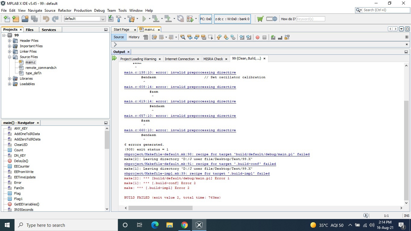

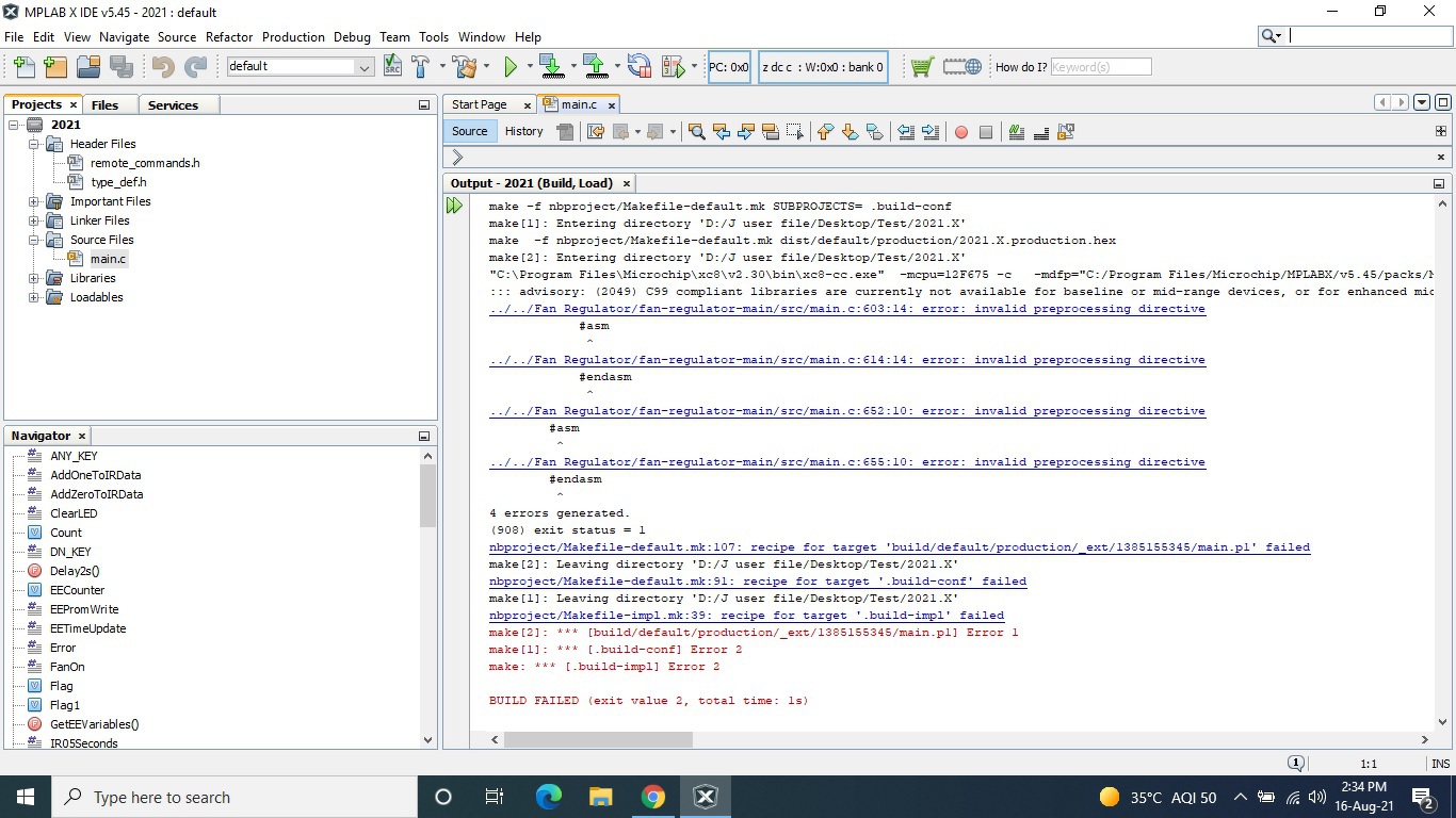

Dear as I tried to compiled in xc8 ,I found 6 errors as attached below:
1. file no.1,with changes told by you 6 error.
2. file no.2. without any change 4 errors.
(#) Hp41C válasza Naresh Jain hozzászólására (») Aug 16, 2021 / 2

first of all, this program was written in 2010 - 2011, so it is better to use the old IDE form Microchip (the MpLab8) and an old version of xc8 (in my case V1.33). Sorry the syntax has changed sinse then.
A hozzászólás módosítva: Aug 16, 2021
(#) Naresh Jain válasza Hp41C hozzászólására (») Aug 17, 2021 /
Dear friend Hp41C, I run the code successfully now, you are really great, you are helping others without any personal benefit,
